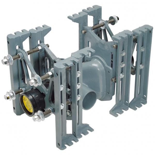

Series ISCA-102-D Industry Standard back-to-back horizontal adjustable water closet carrier with epoxy coated cast iron fitting, 4 in. (102mm) no hub waste and 2 in. (51mm) no hub vent connections, epoxy coated ductile iron compression seal faceplate assembly, epoxy coated ductile iron foot supports and rod support assembly adjustable for standard and wheelchair height, ductile iron rear anchor support, adjustable ABS nipple with integral test cap and neoprene bowl gasket, stainless steel support rods and hardware, and chrome plated cap nuts. Carrier complies with requirements of ASME A112.6.1M up to a 1000 lb. (454 kg.) static load. The closet carrier legs are embossed with incremental measurements markings, allowing contractors to easily adjust the height of the carrier to the most commonly used fixture requirements.
