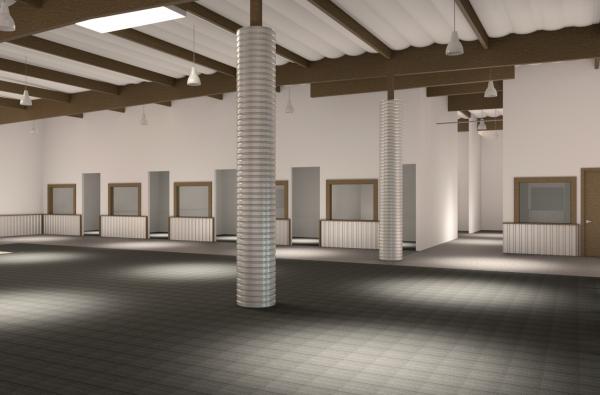

This is a profile for a corrugated mullion to make walls with corrugated metals.
To use the file load the profile into the project. Go to mullion and create a duplicate of the mullion and name it corrugated and select the profile you loaded in and set the material you want and click ok. Now Create a new curtain wall set the vertical grid to fixed distance and the spacing to 6-1/2" check the box for adjust for mullion size.
Set the horizonatl grid to none. Set the interior type vertical mullion to the mullion youy made. Now you are ready to draw currgated metal walls.
Renders perfectly and works for walls and roofs.
