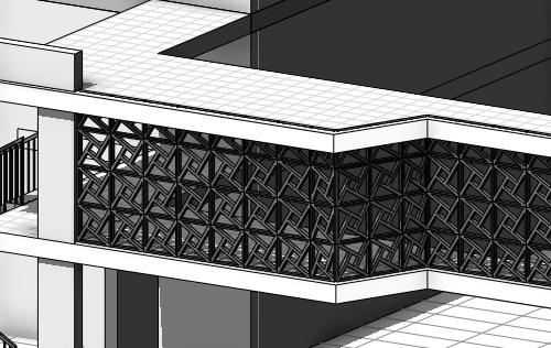

Simple geometric design in a precast conc. panel. The panel can be used as Curtian panel in Revit work flow.

how do we place it on top of the curtain wall?

Hi, load this family in the project, create a curtainwall, and change its properties, edit type, choose this family in place of the curtain panel.Set the number of divisions of curtain wall as u like. it will adjust to the size of panels the curtain system offers. Else u can unpin an individual panel and replace it with this imported family one by one.
