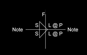

WELD SYMBOL

I would like to be able to edit this, but even our Architectural Intern, a Revit teacher at a local community college, cannot figure out how you made this ! Can you let me in on your secret ;-) how to edit nested families like these ? I really just want to fix the tail to 45 degree angle lines like the standard, but thought this would be a fun family to master. Thanks for uploading it, and for any advice.

Can I ask how you made the leader populate from the inside of the all around symbol? Everytime I try to replicate it the leader always populates from the outside of the circle
