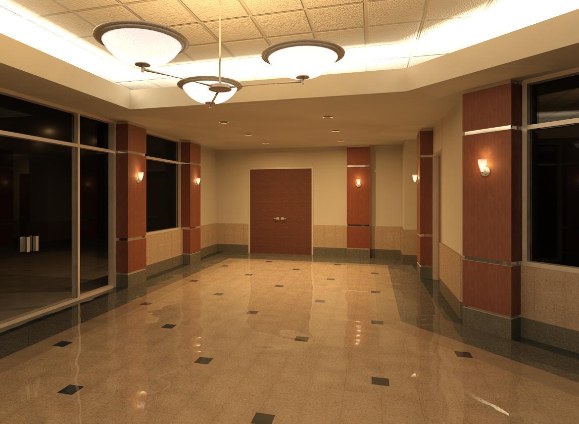

Howe Electric_Lobby_IES_02
Uploaded By: ericq

Marvelous work, te quedo súper chévere. Would you share with me how to use those frameless glass doors, I tried to use them but somehow it refuses to attach to the glazing. How did you have it to work?
Thanks!

arcnline.....first you tab select the mullions you want to remove until you have selected the dashed line for the whole row/column. Then you click the add/remove segments button at the top, and continue until you have all the mullions you want removed.
You have to load the Curtain wall door families in the doors folder. You then tab select until you have selected the the glass you want to convert to a door, and change the type to Curtain Wall Dbl Glass.
