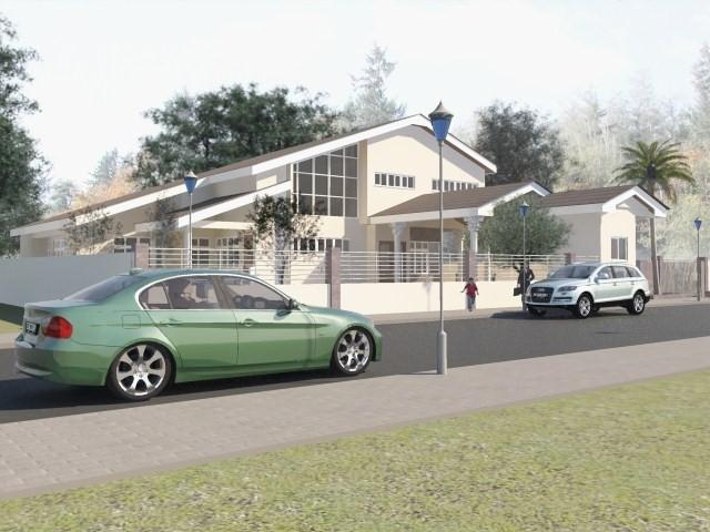

Description: Modeled in revit 2009 and rendered in max(mental ray)

Clever background, that fadeout effect brings the architecture to primary level.
Now… can you share the technique used?
Nice work!

Thanks for the comment much appreciated.
The backround image was placed as an enviroment map in the enviroment and effects panel.Made sure process background and enviromental maps was also activated and tweaked the images output settings,mainly increasing the output amount & RGB level to make it slightly brighter.The color map was enabled,used the mono setting and manually made the image lighter by adding a curve point to the line & gradually moving towards the top left corner.

where can i get diferent families? like your car, where did you get it? did you put it in revit or in max? tnx
Mon, Aug 25, 2008 at 4:26:25 AM
reighnmann
Joined Thu, Aug 21, 2008
rafire which families are u talkin about
Mon, Aug 25, 2008 at 4:36:18 AM
reighnmann
sorry the cars were placed in max.
Mon, Aug 25, 2008 at 4:44:15 AM
reighnmann
checkout 3d02.com
Mon, Aug 25, 2008 at 4:45:17 AM
reighnmann
They have some really cool stuff.Hope this helps
