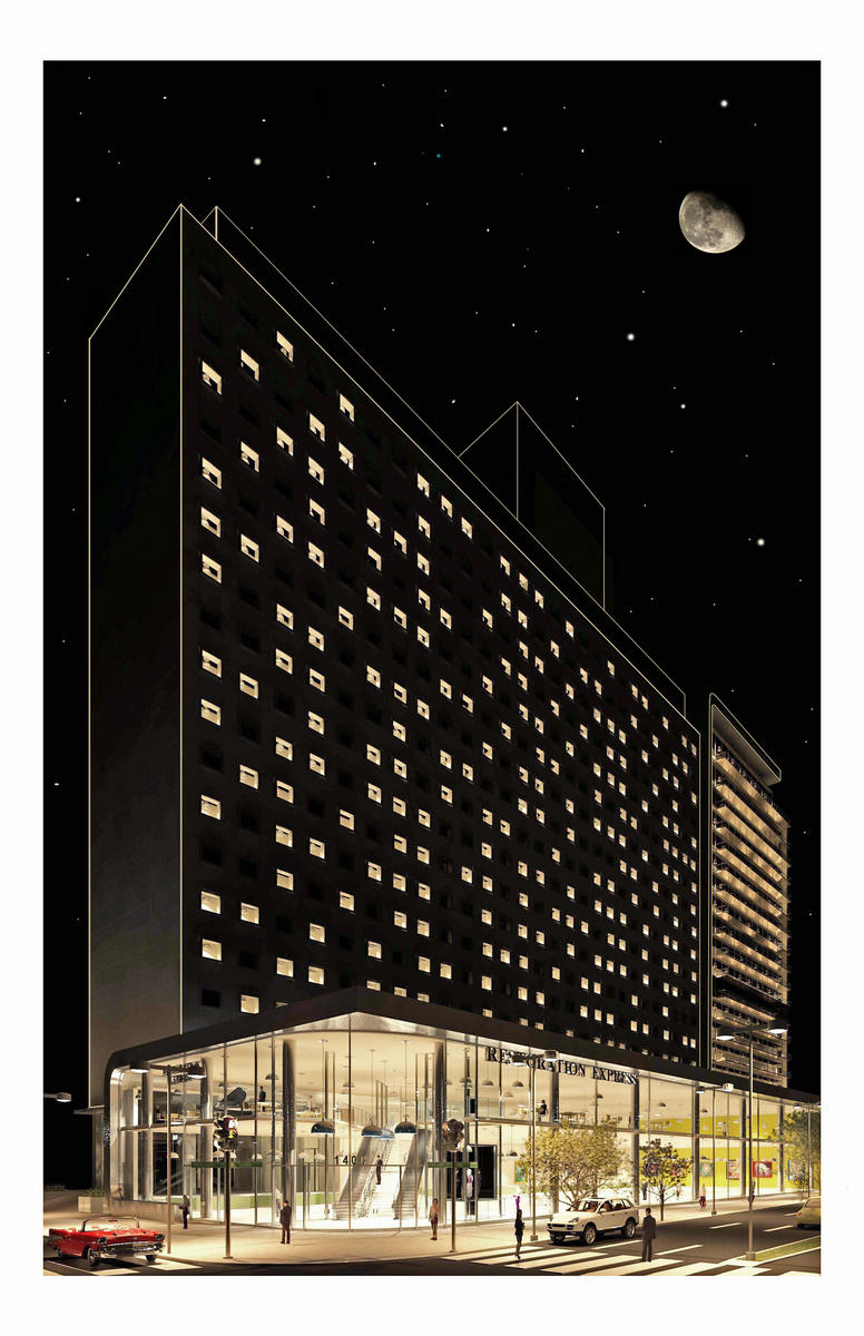

Hi,
 How did you put stars in the sky?  I am not sure if its possible in Revit.  Did you photoshop those in the drawing?
Tue, Aug 19, 2008 at 10:41:34 AM
droweno
Joined Wed, Jul 9, 2008
Nice work!
Tue, Aug 19, 2008 at 10:43:04 AM
droweno
Another question.  How did you make those road marks? Street lights? road signs?  Curious so please help me out.
Fri, Aug 22, 2008 at 6:36:15 AM
ashish2008
Joined Thu, Aug 21, 2008
It is soo good same question here how did u put those stars and moon..........is it background image...????????
Tue, Aug 26, 2008 at 9:45:11 AM
AgathaChristy
Joined Wed, Jun 7, 2006
In revit 2009 when your rendering is ready you have an option to export it to PNG file. In photoshop if it is PNG file it backgroung becomes separate layer and you dont need to cut anything. Through photoshop (believe me I used it for this view first time in my life) put stars use brush. Moon is an image (look through extralarge) from Google images and insert as a packground. Good luck.
Tue, Aug 26, 2008 at 9:58:08 AM
AgathaChristy
Hi guys,
Sgreet lights are generic models. Create generic model and separately lighting ficsture family, but just light souse element. Load this light sourse element into generic model. Now you can light your street light. street names is a part of generic model street light. Road marks are subrigion from Site Design bar. Also you can use split surface. Just assign different finish. Glossy paint for example and it would be reflective if you wan to render night view. Good luck.
