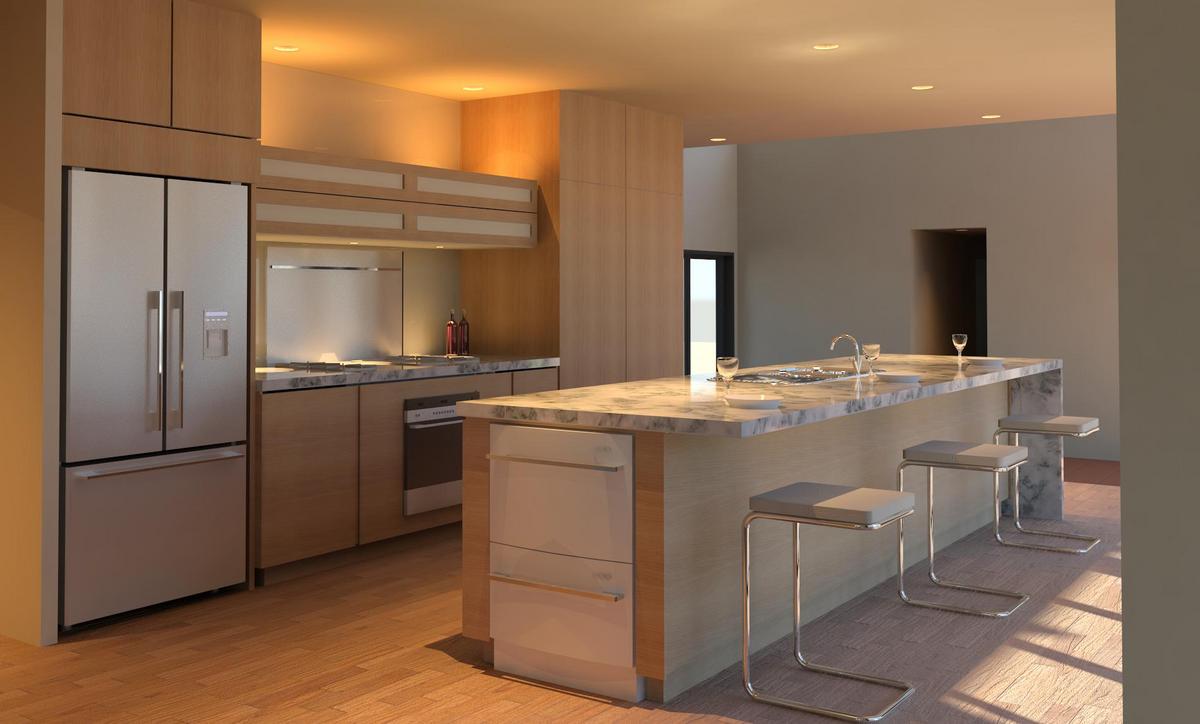

Description: This is a kitchen we designed, modelled and rendered using only Revit Architecture 2009.
100hrs (dual core laptop - not the best for rendering admittedly)
& 100% Revit.  Has not been touched in any other program

Very nice render... I like it.... 100% REVIT.

very nice!!
one thing i find strange is the cyling (sry if my spelling is wrong ) looking orange and the back wall has none of that orange, kinda the same with the floor in the kitchen and in front of it,

could you please share the rendering settings you used? i am having trouble with "interior artificial and sun" with getting the artificial to actually work... any ideas?

also, i am having trouble getting the sunlight to really light up the interior, and i did check the portals box

are u saying you spent 100 hours on this ????

Are you using IES data for interior lighting? I have found the combination of lights with IES photometric data + daylight portals work very well.....

Please explain what IES data is?
