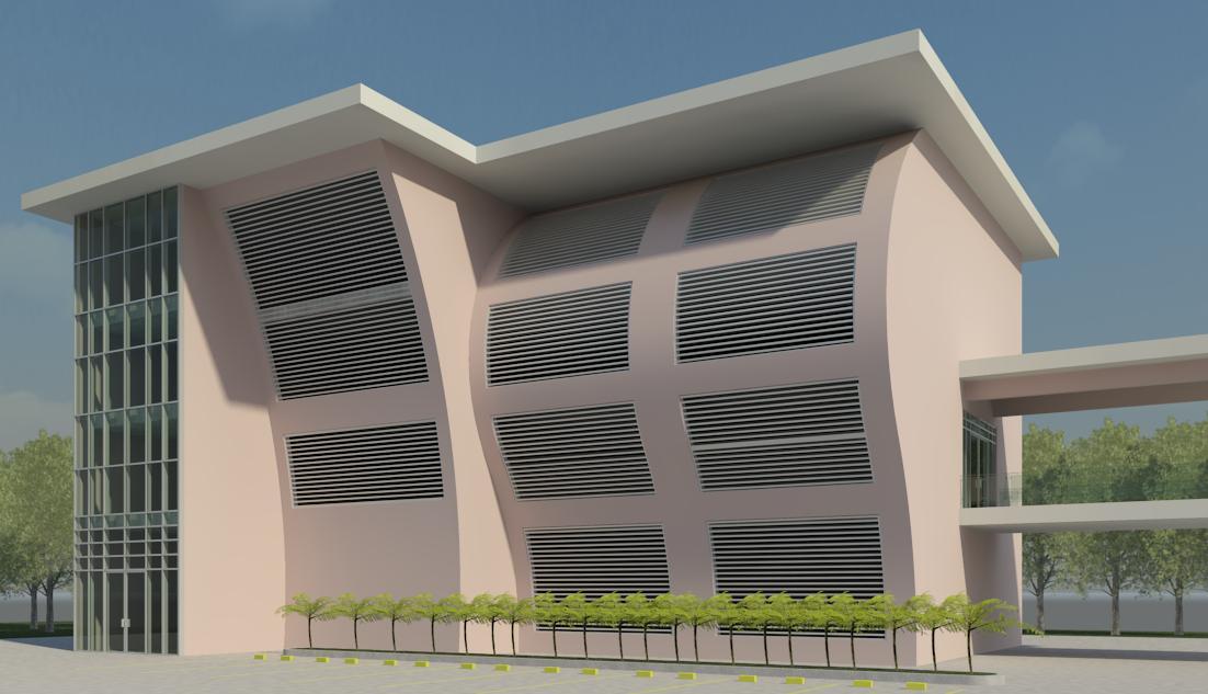

Description: My friend ask me if its possible in revit to put a louver in a curve wall following the wall profile.

How did you get the windows to follow the curvature of the wall?

try to use massing solid and void thene convert it to curtain system but make sure to turn off the vertical grid line then you can apply mullions
