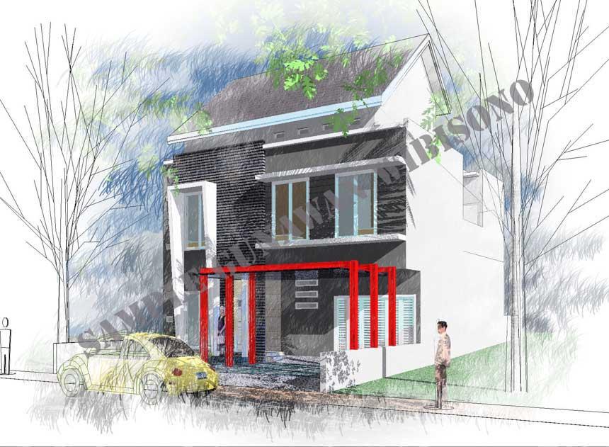

It should be a coloring pencil looks.
Modeling & rendering in Revit.  Finishing effect in Photoshop.
I made it base on Tutorial by Skishout : A First Look at Layers with Photoshop (http://www.revitcity.com/tutorials/photoshop_rendering/)
I found it is rather dificult and need long time.
So I skip step 1 until 8 and replace the upper layer (photoshop)  with the image directly exported from revit without rendering it.
Choose the hidden lines black and white.
Remember to adjust the image size to be the same as the view image rendering would be,
so we did'nt have to adjust it later in photoshop.
Render the image and copy / place it to the lower layer.
Go to the upper layer again ( hidden line black & white ) and make a mask.
Do some gradient or eraser to the mask and the lower layer ( rendering image ) will be revealed.
Have a nice try !

Another wonderful rendering, Bison ..... love the colored pencil look.  Thanks for telling us all how you did it   :  Winking

Thank for your useful tutorialWinking
