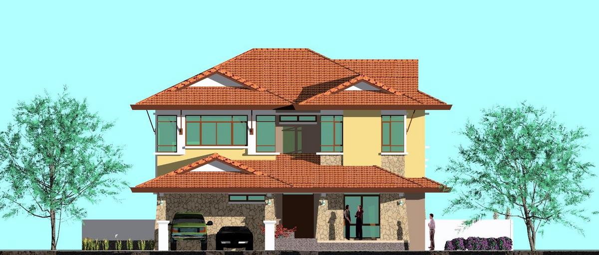

Elevation Rendered in Revits

One more malaysian here :-) Just wondering how you rendered an elevation because the render option in the design bar is always greyed out in elevation view.
Wed, Jan 23, 2008 at 4:55:08 PM
jimbo614
Joined Mon, Jul 23, 2007
to render an elevation, you need to ORIENT VIEW to your elevation. First, go to your 3D view. Then DUPLICATE VIEW WITH DETAILING ( so you have a copy ) Third -  ORIENT THE VIEW to whichever elevation you want. this will allow you to render the elevation.
What you are actually doing is assigning a 3D view ( which CAN be rendered ) to a specific  elevation. give it a shot

Excellent tip mate. Thanks fo sharing :-)
