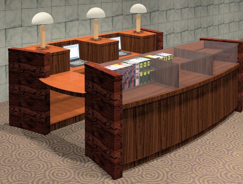

Description: This rendering started life as a Sketchup model.
I exported the Sketchup faces to DWG, and brought it into ACAD. I ran my routine that puts faces on their own layer by color, then applied materials to the layers with Accurender 4 beta. I then brought it into Revit and added a ceiling with spotlights, the computers, and the table lamps. I refined the materials further.
The computers and the books started with downloads from accustudio.com. I had to add a solid to the laptop screens so the decals would stick.
