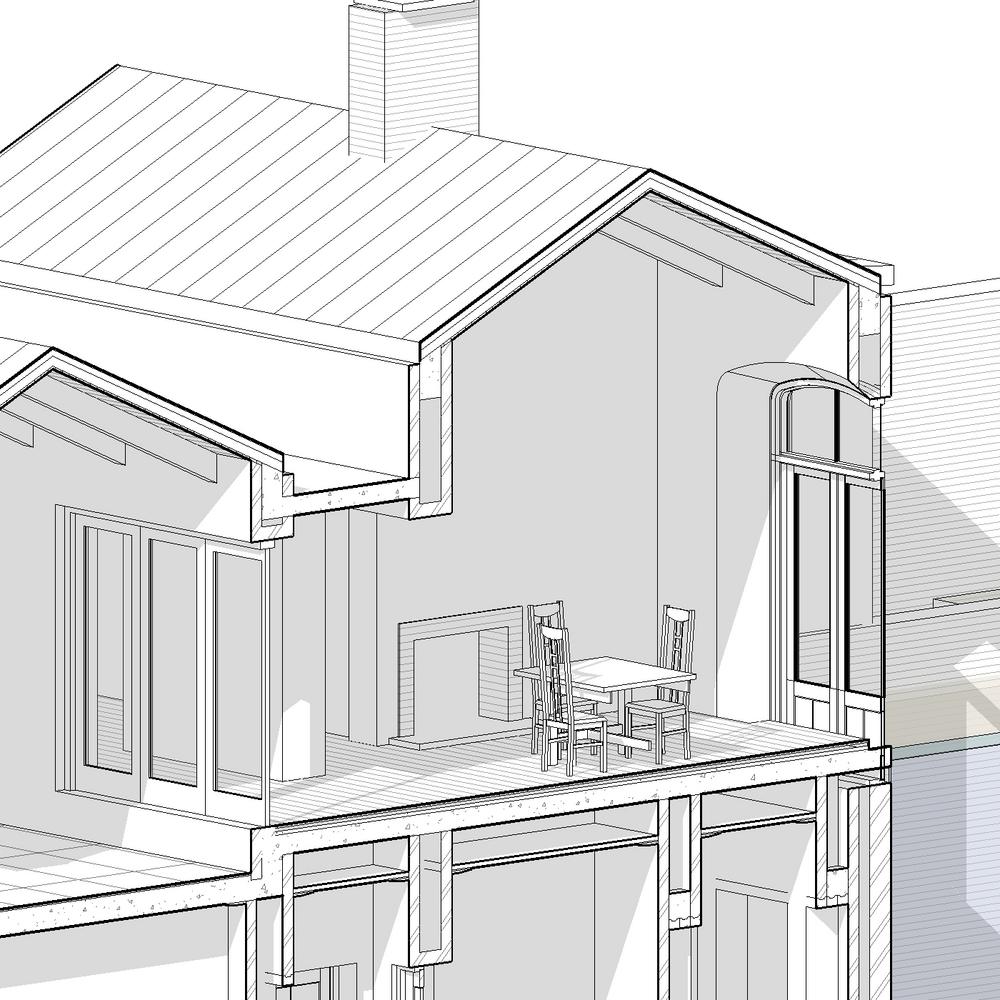

Sectional iso - detail2
2.5 Stars from 2 Votes
Uploaded By: eday
Tue, Oct 17, 2006
Description: Non-rendered sectional detail of new house. I'm not a big fan of rendered graphics - prefer the stipped down line drawing and shadow study - let the imagination do a bit of work
Tue, Oct 17, 2006 at 2:29:36 PM
jmickle
Joined Tue, May 2, 2006
Wondering If you could let me in on how you did the Section in 3d
Wed, Oct 18, 2006 at 12:59:46 AM
eday
Joined Tue, Oct 17, 2006
In 3D view go to view properties and tick 'section box.' Close view properties. A wire frame box with blue handles will appear around your model. Move the handles to cut the model as you need it.
