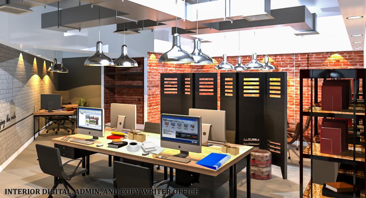

pure revit render?

yes all are rendered in revit some elements only put on photoshop

what are the render settings you use? very nice work.

i used only draft put the seetings on printer make it 300
then go to setting for edit then custom the draft make it copy custom
change image precision 1 - to 8 then after you render the image just adjust the adjust exposure play with it then you can acchieve this effect...
