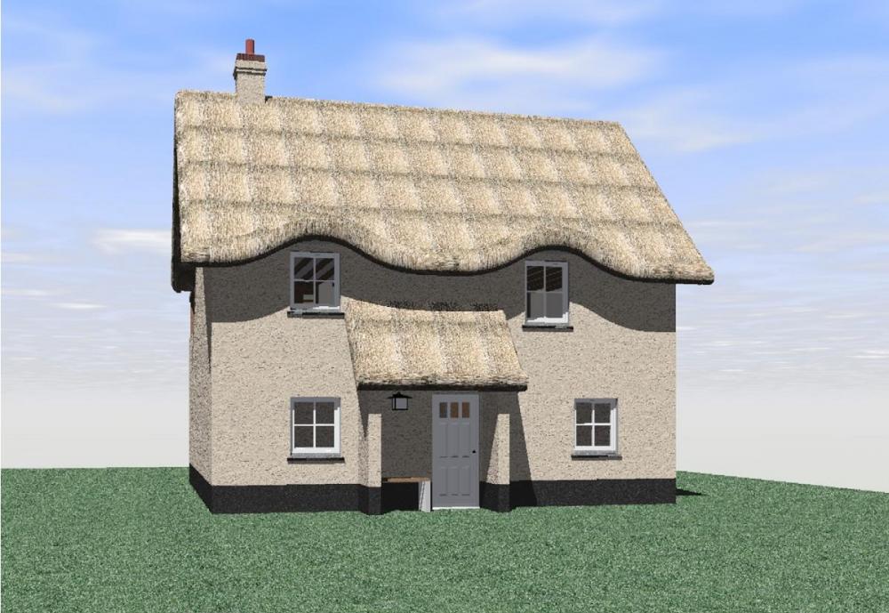

Description: Cottage Thatch design (not linked to Site Plan, just using ground plane)

Nice little house. How did you do the eyebrow on the roof? Gar

Very well done. Would also like to see the fill pattern you used for the roof, battle to get a thatch roof pattern.

the roof was formed using a series of sweeps to the eaves and verge voids were then inserted to "mitre" the joints, the eyebrows were formed using "roof by extrusion" along the front elevation. The thatch pattern was found on the net. The roof looks much better in rendered form than shaded with edges!
