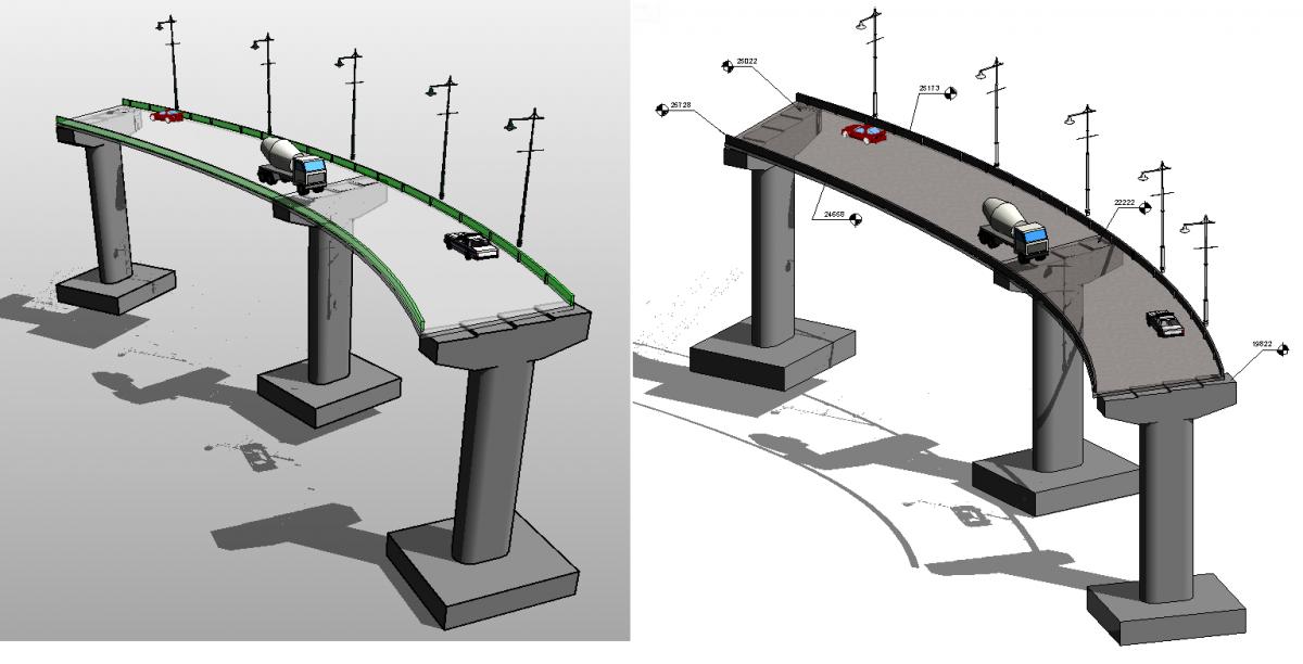

Uploaded By: dgcad
Thu, Jul 17, 2014
Just experimenting with bridges and overpasses in REVIT. The road (floor) has tranparency tured on and I edited the sub-elements to get the complex 3d curve but it works. The piers are made of 3 seperate parametric parts with adjustable parameters. The railings are walls attached to the road (floor) below and a floor above that is turned off. Then there are verticle sweeps along the walls as posts.
