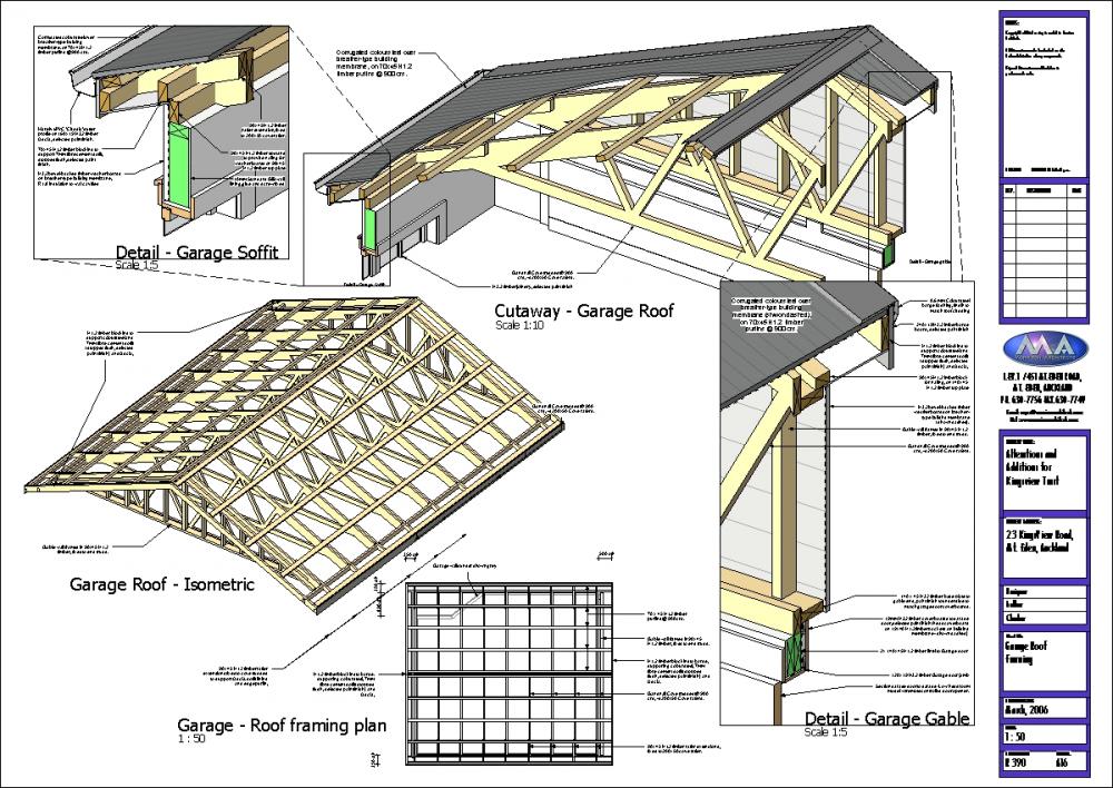

Description: Sample sheet out of a recent set of drawings for the council. Work still has to be done but we're experimenting with 3D details, incorprating modeling with drawing and text.

Wow, great job. I`m wondering how much time that has been used on a drawing like that....? I like it alot

Ummm it took about 6 hrs? (4hrs modelling plus arranging and text) But the real payoff is that thats my sections, elevations and details done on every sheet for the garage. We're huge fans of resolving the modelling in detail, then using that to our best advantage at every stage.

For a detailed explanation of the constructive system used is very good, but i wouldnt ´t use it for construction plans, workers may not understand this proyect clearly.

Whay not use for construction - any builder worth his salt would appreciate the extra detail here-This is the way of the future for construction documents
