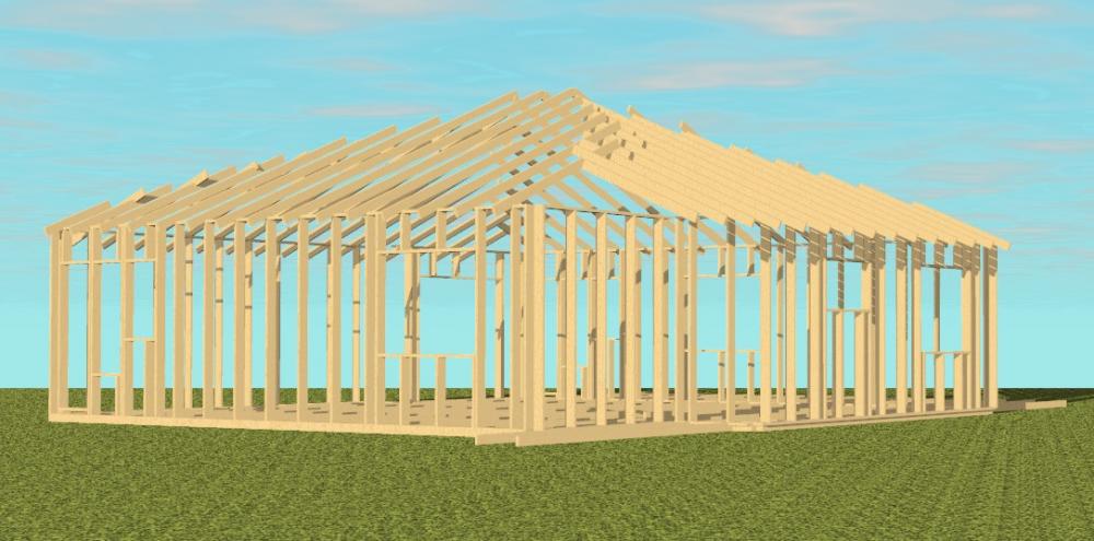

Description: Finaly after many hours of agony i finalized my "work-draft" for the carpenters. hope u like it..........

I hope you dont think the framers will take this seriously! Where are your hip and jack rafters, or how about your trimmers and headers. What are you going to do about in place of eave and ridge blocks? Maybe your noy done, but I also dont see rim or mud sill. Other than that it looks pretty good.

everyones a wiseguy critic lol post it back up if you add a ny more work to it
