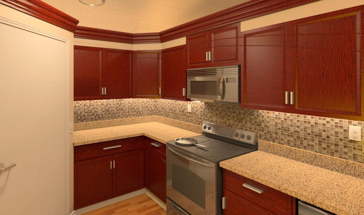

Partial Kitchen View

all by revit?
so nice

Yes, completely in revit

Ive been trying to figure out how to do the mosiac backsplash! if you can tell me that would be awesome!

Basically found an image of a tile pattern i liked on a manufactures website.  Created a copy of the existing material type: Ceramic/Tile/1inc Squares - Mosaic Gray tile material. Under Appearance i changed the file location to the new Image i found. then adjusted the .png file settings under "Relief Pattern" till i got the desired depth appearance i liked for the tile and then assigned that material to the wall surface. Hope that helps.
