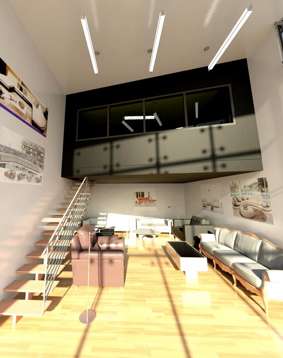

... like the glass panel reflection in the black wall....
... try to create a falimy for the pictures, like a frame... they will look better...
... take away the brown sofa, so the space will lok bigger...

... but looking at the whole image nobody can enter the second floor thru the stair, is too small, too close..

Yeah, definitely a head height clearance issue going on here.

Thanks for your comments
This was just a practice test for rendering.

really nice rendering settings!    nice sun location ... makes the light come through and generate glass shadows.
take out the brown sofa,  the white one looks fancy  Smile

Nice rendering..My question is..You have the stringer on thestairs? But with the cuts thats structurally not sound, it wont hold up anything. What do the stairs connect to?

I did not understand your question.

The cuts on the stringer on the stairs, they beam with the cuts isnt structually sound..You need more supports. What is the stringer connected to on the bottom of the 2nd floor?
You would need either a  Steel Wide-Flange beam to support those stairs.

!!!!!!!!!!!!This was just a practice for rendering, not an executable work and architectural design, please read the comments other members!!!!!!!!!!!
