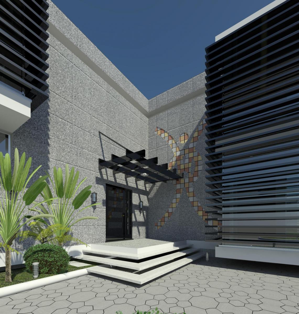

@Siavash, The louvers were created using a plain curtain wall, then swapping the panels for empty panels, then adjusting the horizontal mullion grid to dimension of choice then selecting any mullion ( custom) under the interior horizontal mullion tab. The mosiac design on the wall was created using a sketched void to cut the shape then extruding another in place geometry then apllying the pattern tile. Hope this helps.

great use of curtain walls
Curtain walls are a versatile tool, you can do more with them than one would think...

and you do all this intricate detail work AND develop these great designs AND render one of these projects every four days.. can you say "revit guinness book of world records"?
