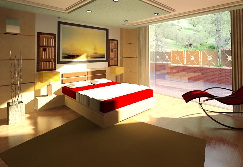

Vista camera con luce solare
Revit 2009
To obtain good sunlight, it is necessary to act on setting sun (direct light) and then sull'azimut or solar angle, that angle will be rotated as the camera. Also set the Altitude, lowering it until you see the light to penetrate as far away from the glass. Another important thing is the material of glass should not be very reflective. Then once you render (internal sun light), turn slightly to the exposure adjustment

nice willi, hw did you get the internal render so bright and beautiful.
