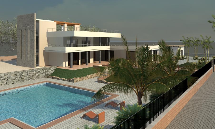

Vista con piscina

I dont know how to create a pool like that could you help me?

Using a generic wall also 20 cm and a depth of about 1:50 m, trace the shape of the pool. In fpndo use the floor command, and close the bottom edge. With sweep creates the pool. With the command "create" do an extrusion in the pool, the same shape, leaving at least 20 cm from the edge. In this extrusion material from the water (pool). The key thing is the material that you attach to the sides and bottom. From such a mosaic material that gives the azure. Try it and let me know if you want to email: @ roberto.salvatore ater.frosinone.it.
