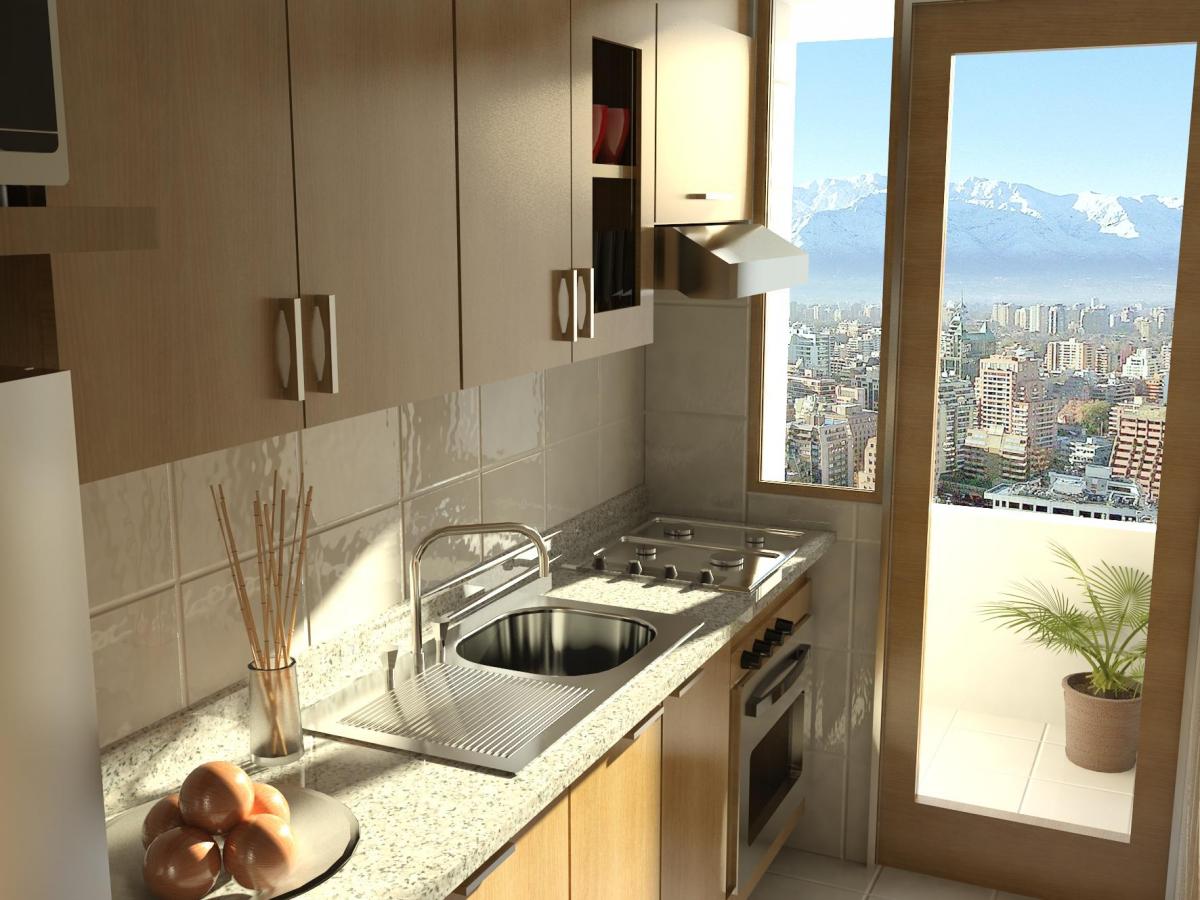

Small kitchen for an apartment complex in Santiago, Chile.
Entirely made in Revit. Comments are welcome, help me improve!
Fri, Apr 15, 2011 at 9:03:02 AM
papanicolas
Joined Thu, Nov 4, 2010
I mean ENTIRELY on Revit 2010. No photoshop. Background? Here´s how:
http://www.nicolasgeister.cl/BACKGROUND.jpg
http://www.edesan.cl/wp-content/uploads/2011/02/santiago.jpg
Thanks to Rk for questioning the "entirely" part.
I Hope this would be helpfull for someone, and please excuse my english

Simple but well fatto.Buona sunlight.Cure, I think, the better the details

Very good sunlight.What settings did you use to render ? Did you make use of artificial lights?The gaps betwen the ceramics were made with voids or bumps? If bumps would you be so kind to send me the settings you`ve used?
THANKS

Alberto, thank you for your comments. No artificial lights were used. The bump map used for ceramics is the one that comes inside the Revit basic library (TileSquareBump.jpg). Other settings:
Tipo: Cerámica
Color: Un sólo color RGB 232-222-217
Acabado: Brillo alto/Vidriado
Relieves de acabado: Ondulado
Cantidad: 0.05
Patrón de relieve: TileSquareBump.jpg
Tamaño: 0.6
Cantidad: 1.2
The sunlight corresponds to Santiago, Chile, on December the fifth (05-12).
About the rendering settings, not much difference with "optima" quality (translation? Best?). Just lower reflection, refraction and transparency, because these subjects weren´t so important in this image.
