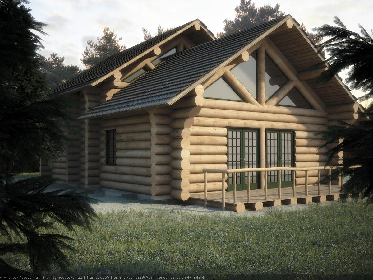

Description: This  project  was a chalenge for me, because in the past i used to model the log houses in 3ds max, but as i love revit i decided to try to remake this house in revit.After all the frustration about how to make the walls and different technique in the end i was happy with the solution i have foud and now i think is way faster and better to this kind of houses in revit. The render is done inside 3dsmax and vray was used as the render engine

AMAZING GREAT WORK HOW HARD IS IT TO ASSIGN MATERIALS ONCE YOU EXPORT FROM REVIT INTO MAX? ALSO IS THE ROOF A MAP WITH A BUMP OR IS IT ACTUAL EXTRUSIONS? GREAT JOB

Love it! Good job!

WHY DOES EVERYONE TALK LIKE THIS? YOU SEEM SO MAD. Either way, great design.

Can not have that result only in revitt! an excellent modeling and design.

so finally wat solution u found?

hello everybody and thak you for your replies.
 The mai problem of this kind of houses are the walls, i saw an tutorial on revit kid where he was trying to make such a wall but in the end i think it failed because he can not put doors  ore windows in it. So i madem by making a wall based family where i modeled what i wana cut out from a normal wall so that it will have the shape of a log wall. After many trys a think i managed to come out with a good parametric wall based family that allowd me to model this very easily. As i am not very good with rendering inside revit and i never render inside revit , but i am making the facades sections and every thing else and love the way that they are comming out. The roof is with displacement map. Sorry for my english

Here you have a tutorial from WWHub about "Log Walls" one year ago: http://www.revitcity.com/forums.php?action=viewthread&thread_id=17944

He uses the same technique, it would have benn nice to find this before i lost 2 days tryng to figure out wow to make them. The only tutorial on them that i found was on revit kid.

Looks great! Why didnt you just use wall sweeps?
