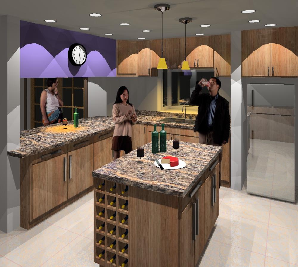

Kitchen Interior
3 Stars from 2 Votes
Kitchen Interior
Uploaded By: joferlys
Thu, Nov 17, 2005
Description: Interior Design _ Kitchen
Thu, Nov 17, 2005 at 12:09:56 PM
TomDorner
Joined Sun, Apr 25, 2004
4.5 Stars from 25 Votes
Very nice! I like the wine and cheese on the counter top, adds a sense of realism. I would however run some radiosity to help soften the light from the ceiling fixtures so it is more diffused on the soffits and walls. The other trick is since there is no global illumination in Accurender is to place a couple of studio lights into the scene. The studio lights are in the Revit library under lighting and they are orbs of light not tied to a specific lighting fixture. Place a couple of them at 4'-5' above the floor and they will cast some light upward to help brighten the ceiling and the scene in general. Make a couple of these tweeks and I would give it 5 stars. Tom
