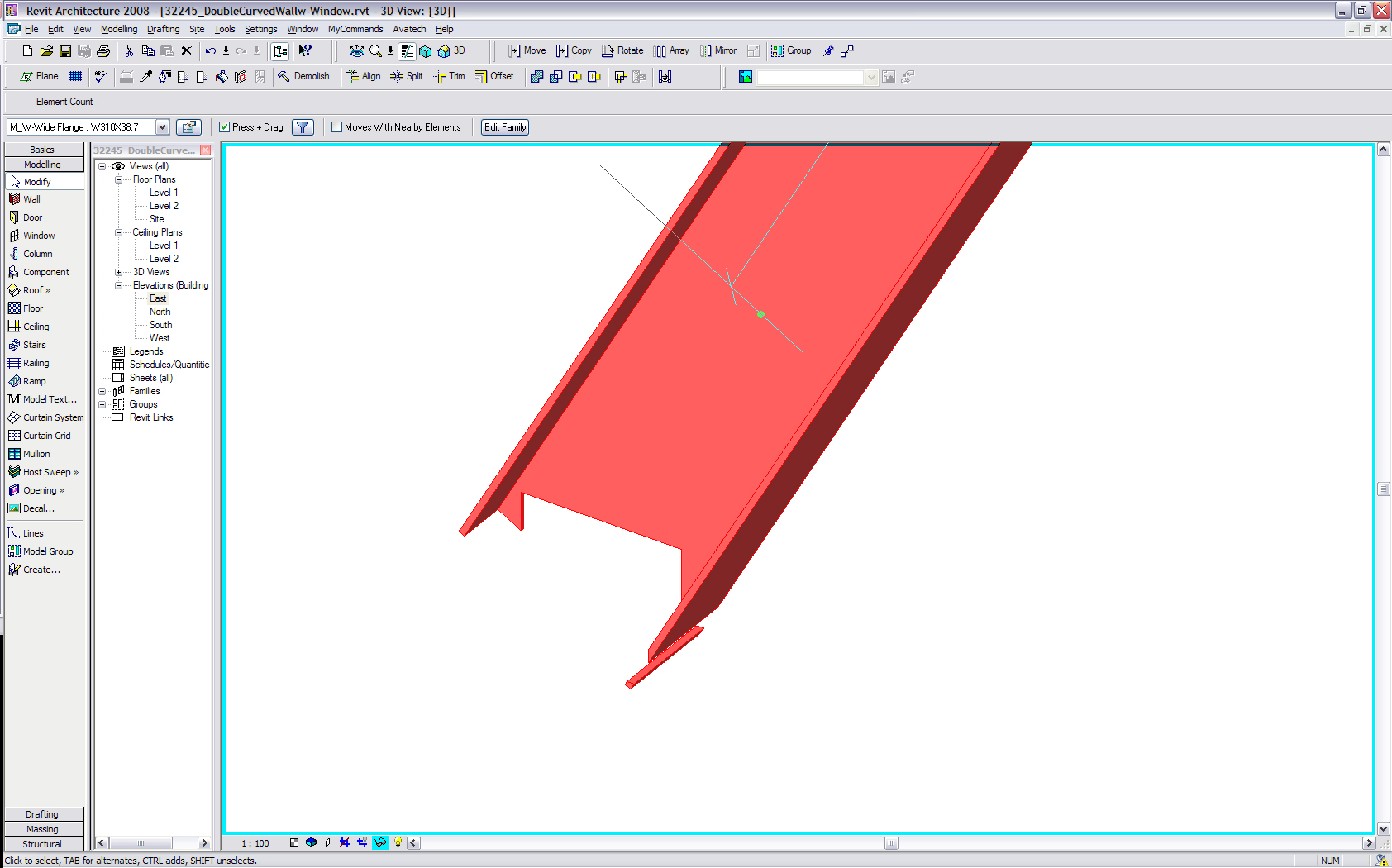

I have two round columns, one sitting on another that I need to join, as well as joining the top one to a square column. What I have now is shown in the attatched image.
So my question is, how do I do this? I'm using Revit 2008. Thanks for any help.

It may depend on how these were created but have you used the join geometry tool?

yeah, the join geometry tool didn't work.

I would just try the opening by face option on this. Extend the column to cut a little extra then on the modeling tab use the opening by face and cut out what you dont need. I would do this same option for the top.

I thinkyou can go for generic column. this should be work.
