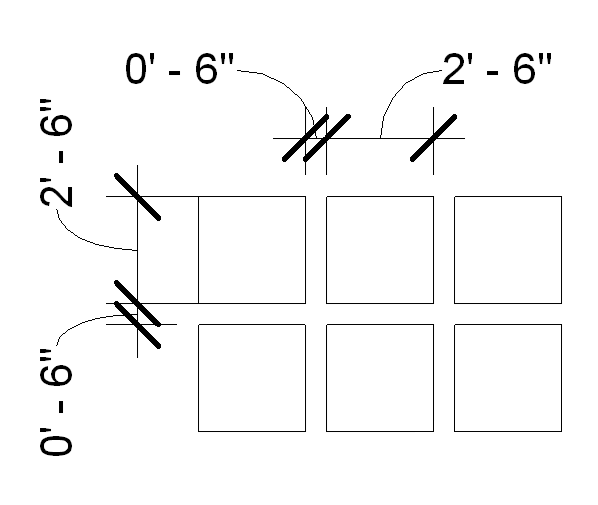

I am making a waffle ceiling and I'm trying to create a reflected ceiling plan.
all I want is a hatch pattern  2' 6" square thats spaced 6" apart.
Can anyone give me that hatch pattern or tell me an easy way to make it
 I posted an example picture of how the fill pattern should be. PLEASE HELP!

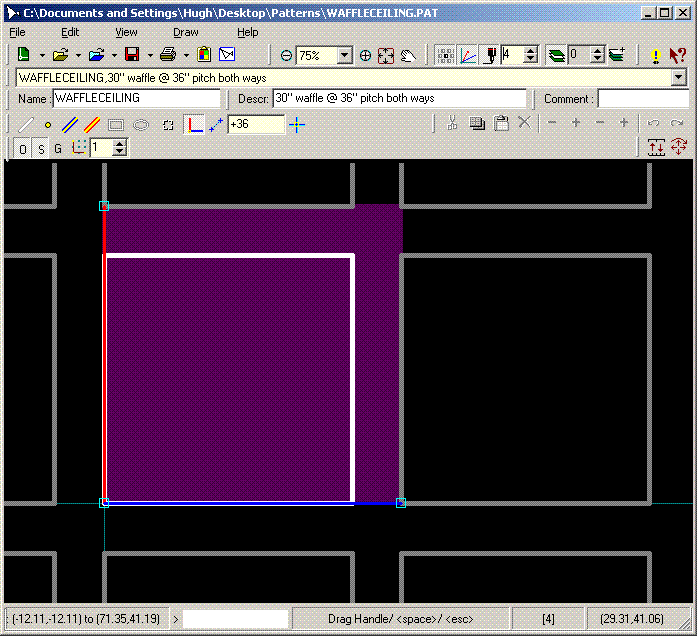

Try this
 ;%VERSION=3.0;%UNITS=INCH*WAFFLECEILING,30" waffle @ 36" pitch both ways;%TYPE=MODEL;-------------------------------------------------------------------------------;        Pattern written by HatchKit v2.7 Hatch Pattern Editor;        HatchKit v2.7 Hatch Pattern Editor(c) Cadro Pty Ltd 1990-2007.;        www.cadro.com.au/hatchkit/;-------------------------------------------------------------------------------;-Template=NEW,;-Date    =17/01/2008;-Time    =12:51:56 PM;-HatchKitVersion=2.7.1.1980;--------------------------------------------------------------------------------90,0,30,0,36,30,-6180,30,30,0,36,30,-690,30,0,0,36,30,-60,0,0,0,36,30,-6

Hmm, that would have been better if I had attached the file instead. Fixed.
Hugh

Thank you Very much that solves hours of research.

No worries, it is a very simple pattern.
Draw a 30" square and space 6" apart.
Save as a Revit model pattern.
