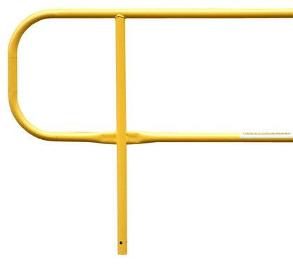

I am trying to create a railing in Revit, ADA requires a 1' extension at the end of most railings..... our firm prefers to have the rounded "wrap around" extension(see image)..... i know i could just create a peice of mass using the create tool, but for cost estimate purposes.... we are trying to eliminate all generic models that serve basically no purpose in the cost estimate.... What is the correct way to have the end of the railing the way i want it when u can only edit a railing in plan view???

I read somewhere that you can make a custom baluster family that includes the extentions and then use it as the End post for the railing. I have not done this but it might be worth a try.

Thanks, i created a new balluster family and basically made it what ever shape i wanted and then went into the railing properties/ balluster placement and switched them out.
