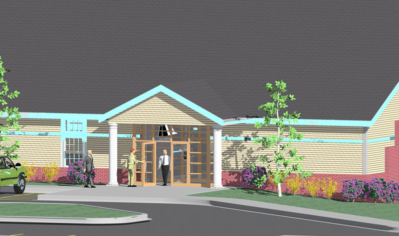

2) I keep running across an issue where I'll assign a material, to fascia board for instance, but when I render it picks up the skybox color(s) and render them instead. But it's not consistent. Not all of the fascia board will pick up the skybox. I've done a global override for the material type but have yet to have any luck. Any ideas?
I've included an example of what I'm talking about in this question.

I live in the Oregon/Washington area. When it comes to rendering it is all about the matterial or materials that are attached to the objects that you are rendering. For instance if you have a brick wall then what you need to do is go to your materials and see what image is associated with that brick. You do this by selecting "settings" then "materials". Once in the material list, find the massory-brick. When you select it you are offered a surface pattern which you can change for you elevation views and an accurender option that is for rendering. These to area can be totally different. If you select Accurender you will see many options. Play with this and I think you wiull be able to figure out you problem.
Special note... Rendering images in accurender are in an 18"X18" format. If you want to be a little more advanced then you can make your own materials by attaching your own images. Createand have fun. I use snagit to capture textures and paint styles and save the images in an 18"X18" format.
I will be happy to help with any further questions. Have a great day.

Thank you very much. I appreciate the help. I ended up changing the material associated with the objects that were giving me trouble and voila, problem solved.

Where did you get those great people in your rendering?

I believe I found those people in the Revit web library.

Wow, I must have downloaded the wrong ones.  I'll look again, thanks!
