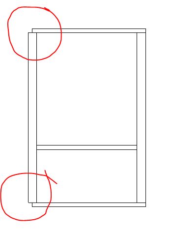

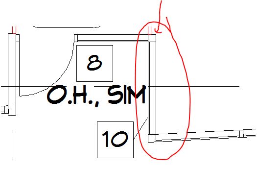

I seem to be having a similar problem.
I'm creating my Interior Glazed Openings sheet.

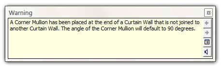

I have the condition in CW 1 attached below. The 5x5 corner mullion is attached to the vertical curtain wall, and that is the elevation I want to show. When I put the mullion in I get the error message in the Warning.jpg.
I can not figure out how to join the curtain walls, and because of this, I assume, I can not get the top and bottom horizontal mullions to go fully across in my elevation. They either go midway on the 5x5 or the 5x5 extends up.
See CW 2 & CW 3
I have tried searching here and the help file but can't seem to find an answer that explains how to join the curtain wall.
As you can see I have no problem with mullion on the south end of the wall.

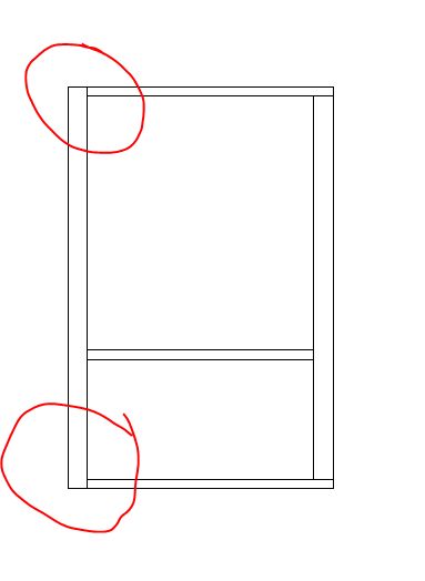

Where'd my attachments go??
See if this works...
