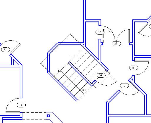

I've two challenges. One is as you can see from the attached drawing I need to dog ear the midway landing. Two is how in the world do you make the door swing different than a 90 degree opening? Again in the drawing attached doors 17 & 23 cross through each other and it does not look right. Well there are a couple of challenges for today.

Challenge #1: Stair, in edit mode you have the boundary tool that allows you to customize your stairs landing to the shape you need it to be. Remember to close all loops in order for the stair to work. Chanllenge #2 : You can create a door family that has a swing at different angles. This parameter can be added to family so that you can control it in the model. That way you can just bring the family in and make global changes to the entire model. For instance if you had existing doors with existing swings. The default doors don't have a parameter for door swings. So hopefully this helps.
