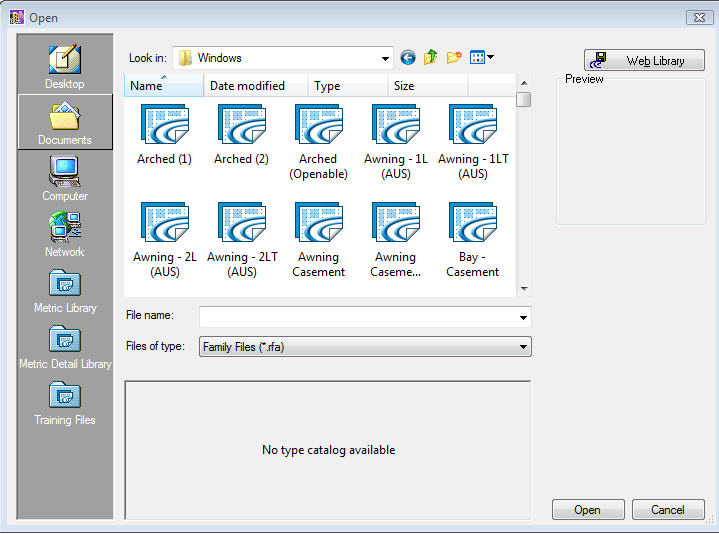

revit formerly will display thumbnail image for the file open browser on window xp. now that i switch to vista, revit now display only generic icon and no thumbial preview. is there any setting that i can do to make revit display the thumbnail preview? pls help...

Sounds like something went wrong with your install.  I'm using Revit 2008 on Vista Ultimate x64 and in load family mode the thumbnails show fine.  They don't display in windows explorer however...

thanks. how do i rectify the problem than? should i reinstall? or is there any other way to update registry to include thumbnail?

I don;t thinik this is it, but....  you can try opening windows explorer, go into whichever folder the folders are in (your c: drive, for example) and then  click organize, choose folder and search options, go to the view tab and make sure that the option for "always show icon, never thumbnail" is not checked.

thanks. however, the option for "always show icon, never thumbnail" is not checked. i am now running vista business 32 bit. by the way, the jepg and avi file shows up thumbnail just fine. i haver tried re-installation but it does not help.

If thumbnails of projects etc do not appaer when browsing but only a big R-icon shows, you could try the following
Run the command window in the Administrator mode (under Windows Start type "cmd", right-click on the result and choose "Run as Administrator"Winking.In the command line then type:regsvr32 "c:\program files\revit architecture 2009\program\revitpreview.dll"A message confirming a successfull registration of the DLL module should appear
David,
Thank you for the idea, but it doesn't work for me. Sorry. May be it happands because I use Vista x64?
