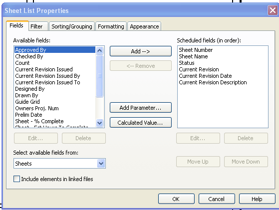

I am trying to create a parameter that will put an "X" in my drawing list if a sheet was associated with a revision.  I have a revision schedule built into my titleblock.  The drawing list would have a column for each revision or submission of the set and if a sheet was issued or revised, there would be an x in that column.  Does anyone know what I would have to do to achieve this?  I am using Revit Architecture 2008.  Thanks.

I have not found an automated way of doing this (i.e. reading the rev schedule and filling out the drawing list), but it can be done. You will need a Yes/No parameter for each revision (doesn't need to be named anything special, 'Issue 1' is fine). Add this parameter to your schedule, and make it a hidden column. Add a Calculated Value to your schedule. Again, naming isn't important here, you can change the heading to read how you like. The formula should be *if(Issue 1, "X", "")*. If Issue 1 is checked (the parameter will show up in the instance properties of the sheets), it will place an 'X' in the cell.
If you have more than a few sheets/issues, I would create a duplicate schedule to work in with the Yes/No parameter columns visible.

We have a revised sheet index in our project.  See attached.

WWHub, how do you get that setup to work when you have non-numeric revisions?
Tue, Mar 6, 2012 at 1:53:10 PM | Revisions in Drawing List
TKennedy - I do not understand your question.  My schedule works the same letters or numbers.

Thanks TK,
I got the yes/no parameter on there and I was trying to figure out how to replace the yes or no with symbols.
What you are describing with the hidden column and calculated value should work great.
WWH, I found the current revision parameters and I think they work great because they are smart,
but my firm is used to their standards and I'm trying not to make too many waves as I push for "The Big Switch."
Also, what is the status parameter you are using?

WWHub, I misphrased that, I mean numbering is set to none. When I do that, all of the revision columns are blank, it only fills them out when numbering is set to numeric or alphabetic.
The other problem I have with using the revision parameters like that is it only shows the current revision for a sheet, and I (and apparently other folks) need a list showing all issues/revisions.
