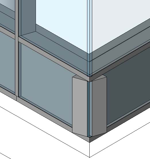

Hi there. Im having problems mitering my curtain wall panels. Both the glass and the thicker panels. It really shows on sharp corners. As you see on the image the mullions miter nice.
When i TAB my way to select the panel, there is no 'Edit Panel Button' in the optionsbar, as written in other threads.
Futhermore i have problems mitering the mullions when i place a vertical gridline closer to a corner than the depth of the horizontal mullion. It doesnt help eliminating the small panel on the inside of the mullions. I've tried making the horizontal mullion continued...
 Thanks for any help
Tue, Dec 18, 2007 at 12:06:32 PM | Mitering curtain wall panels
Don't miter.  Set both to "don't join" then use a corner post on one and nothing on the other.

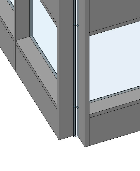

I get the corner post solution... but to throw this into the mix... How would you miter a corner with butt glazing?
Wed, Dec 26, 2007 at 8:45:57 AM | Mitering curtain wall panels
UserError
UserError Avatar
Joined: Fri, Dec 14, 2007
34 Posts
3 Stars: 1 Votes
I would like to know how to do butt glazing as well. Maybe there is another work around but I always have to cheat the corners by extending the curtain wall ends into each other. Then model a seperate corner mullion in.
Wed, Dec 26, 2007 at 9:11:55 AM | Mitering curtain wall panels
I've not had to do a butt glazed corner yet but why not model a corner mullion that is square glass the thickness of the glass in both directions?
