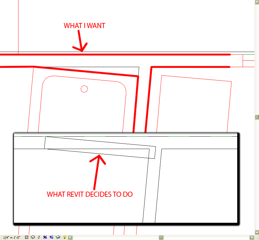

I have a wall that is join off axis and when I try to beef up the inner wall to make the corner 90 degrees Revit can't joing them.  Any ideas on how to accomplish this?  Thanks.

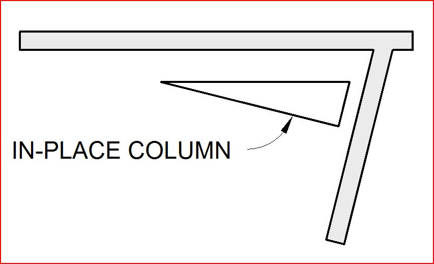

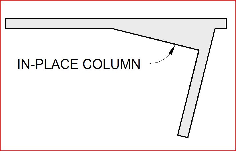

Create an in-place column family. Make sure when you are creating the family, you go to "Family Categories and Parameters" and select "Automatically join". See the attached images.
