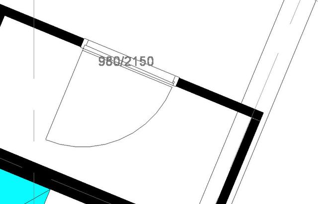

hi all,
 how to align the door tags coressponding to the hosts orientation! can i only choose horizontal or vertical!
see axample!
would like to have it in de direction of the door!
 tell me how?
Mon, Dec 3, 2007 at 8:51:09 AM | door tag orientation!!
JAMESHGRIMES
JAMESHGRIMES Avatar
Joined: Fri, Apr 14, 2006
584 Posts
4.5 Stars: 10 Votes
You need to edit the tag family. Go to Settings-->Family Category and Parameters. Checkmark the "Rotate With Component" box. Save and reload the Tag family.
Mon, Dec 3, 2007 at 11:51:34 AM | door tag orientation!!
elvis
Joined: Fri, May 21, 2004
135 Posts
THANXS,
