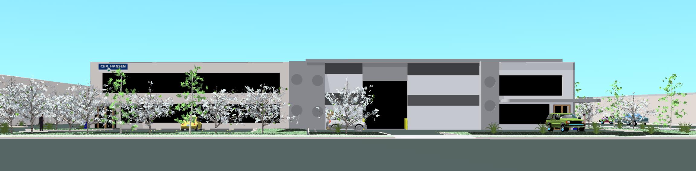

Hi all the Professional People in RevitCity Community, I writing from Australia to introduce my self, and have a little help from u Revit Gurus!!
I have finished a plan showing two warehouses (see picture), both warehouses are set at a floor level of 0.00. Can someone tell me an easy way to raise the floor level of one building only, leaving the other at the current floor level (o.oo).Thanks Everybody, and is a pleasure be part of this Community.

Hi there!
 Create a new Level for your second warehouse.
Then just select all the wall, floors, etc (you will find it easier to use the filter tool to weed out the innappropriate items) and change their level, from within their Element Properties panel.
