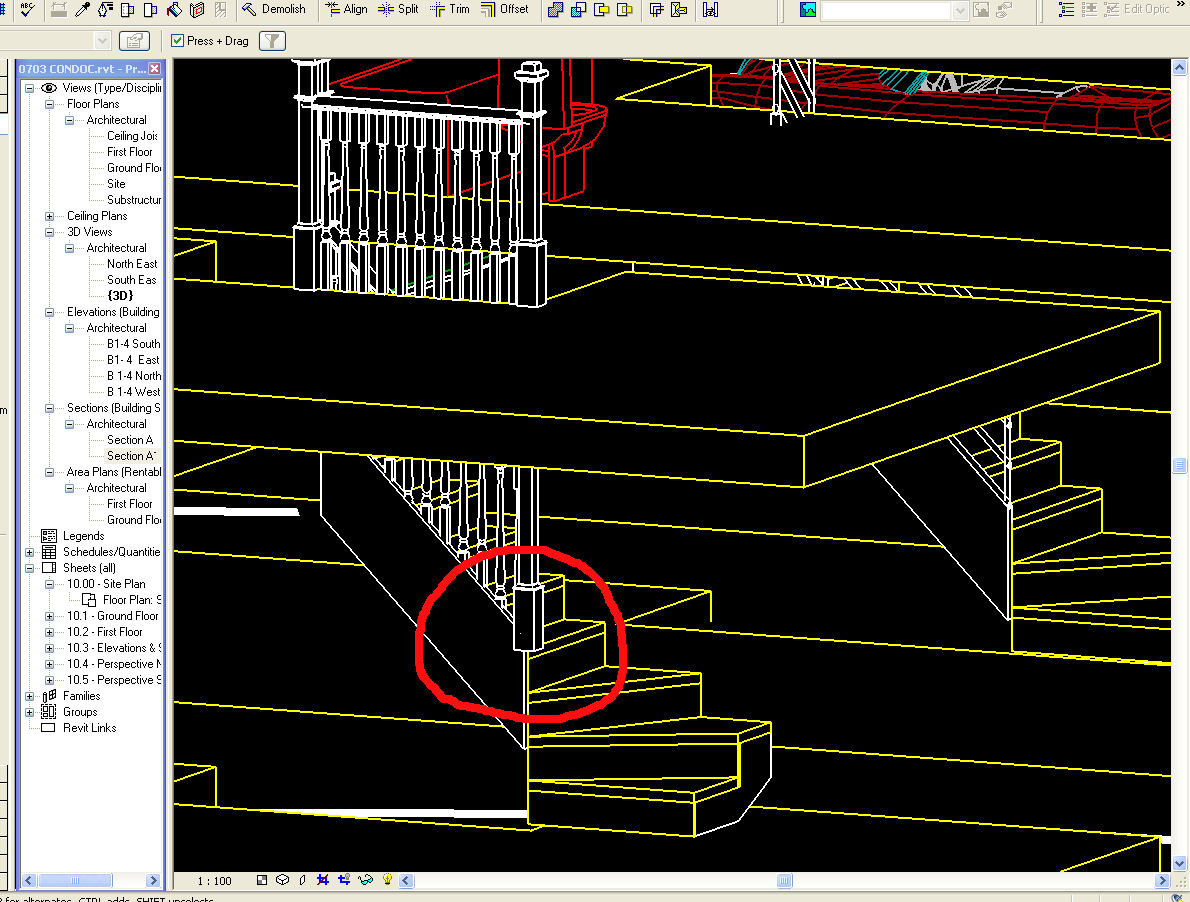

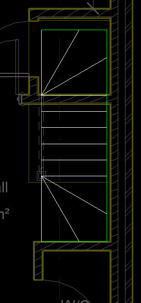

I am also trying to create a brand new railing profile, but alot similar to the autodesk residential handrail type, the one that includes newel posts. I can modify this and use it on stairs but I find where I use one straight run of stairs with winders top and bottom the rail associates itself with the 3rd riser and not to the ground level.
At the top ive had to create a second rail to link in with the sloping rail type but I am sure there is a way to get the rails to connect and have one at the landing height and now follow the winder heights.
