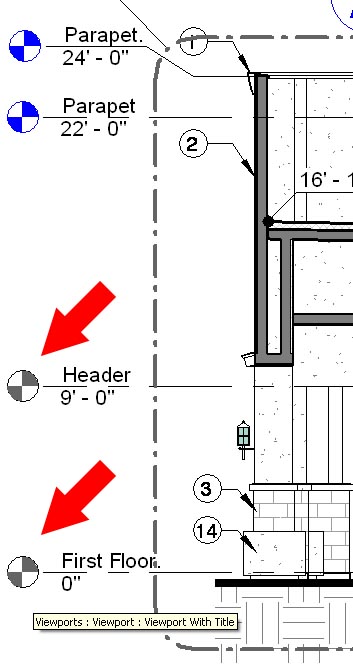

Another question, when the head of the level is gray, what does that mean? I was having this problem at work the other day.
Thanks,
Pietro
Edited on: Sun, Feb 10, 2008 at 11:06:12 AM

I'm not sure about grey heads, but blue means it has a view associated to it, black means no level... As for grey maybe its just confused as  Mindblenreaper sugests. Although I wouldnt recomend pounding on the keyboard  Smile

pamoroso
pamoroso Avatar
Joined: Mon, Oct 1, 2007
65 Posts
4 Stars: 4 Votes
Here is the image of what I am talking about. Does this look right?

Looks like a bug to me, but I'm not really sure. I cant seem to replicate it. Even spot elevations are black.
What happens if you double click on it? If it goes to aview then maybe its acting like a "used" link (blue before you click on it, grey after you have clicked on it once). Although why it would do that I dont know...

When I click on the gray head it does not go to a different view.
Is it possible that its a copied level?
