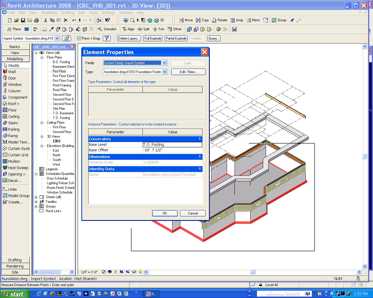

I have imported some 3D graphics into Revit 2008 from an DWG file.  The graphics look perfect yet they are "System Family: Import Symbol" types that I can't seem to change.  Is it possible to change these graphics to different families and or types?  If so, how do you do this?

I don't think you can change the system family at all, but you can change/modify the linework, colors, etc. under visibility graphics.
