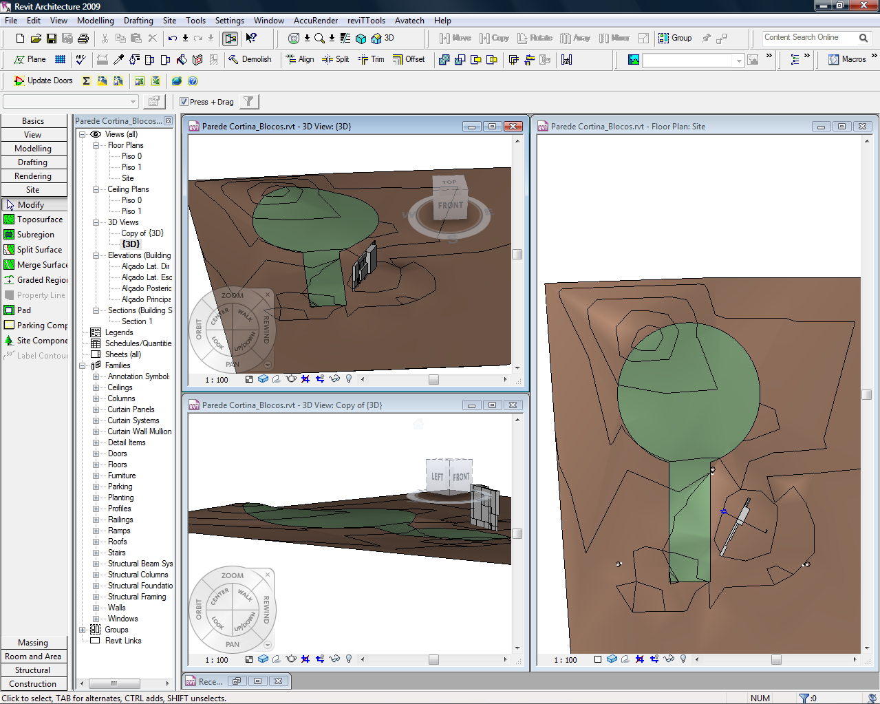

Here is a screen shot. I hope it post.

I used an imported DWG to create the topo. I am going to see if i can get a points file to try and build it that way. Thanks for the help.

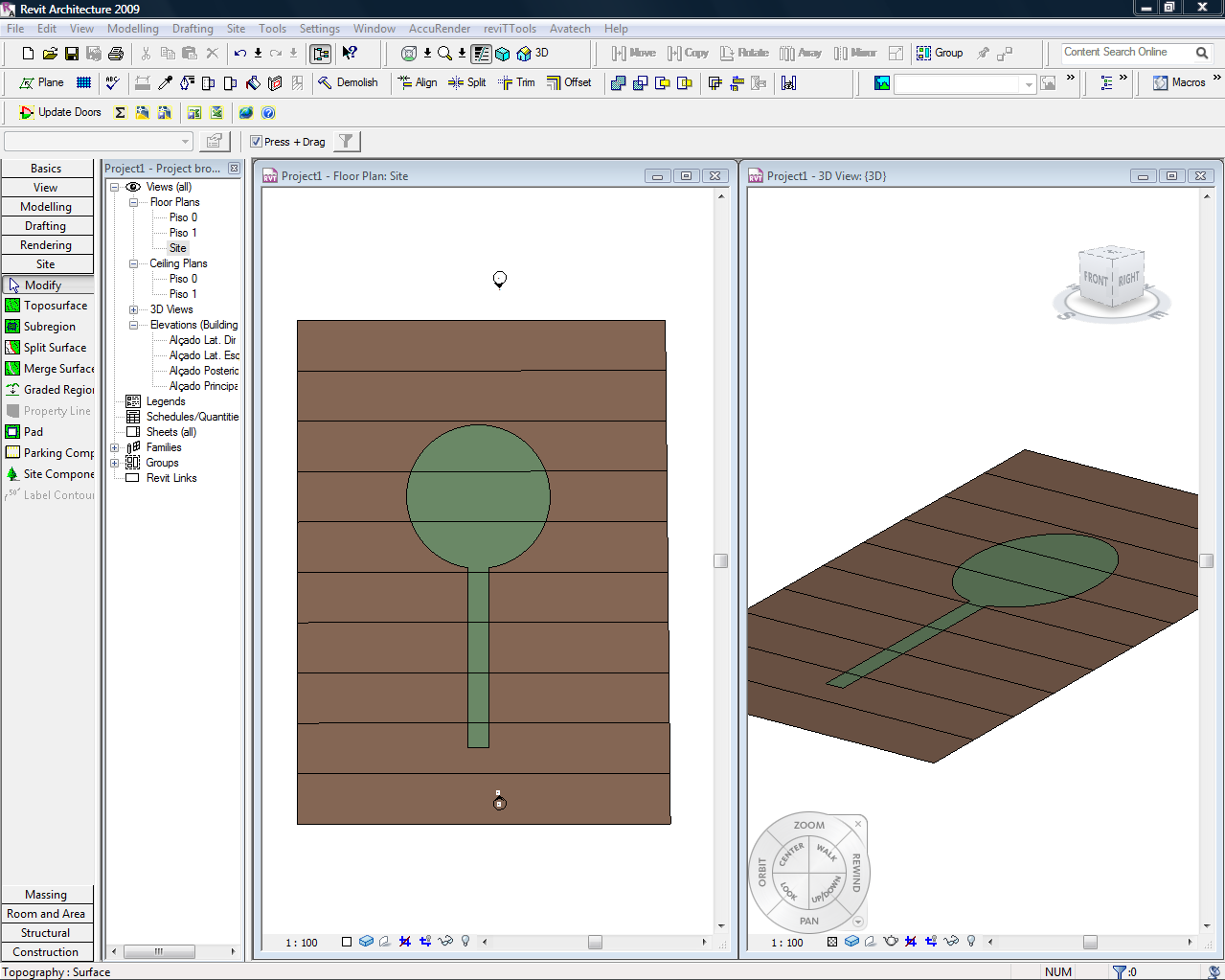

Well, i create another site with few meters by diference between them, with subregion and you can see the result, Nothing compared with your site view...

We recieved a new site plan from our civil engineer and it had more points on it and it smoothed out the edges. Not sure what they did excatly but it works. Thanks for your quick responces to my posts.
