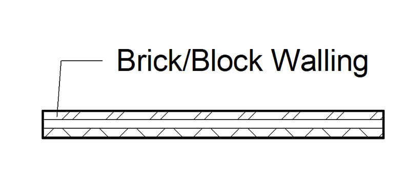

i was looking at this http://www.dgcad.com/Revit9-KeyNotes.asp
and i had ago myself at editing the keynote for drawings, i can edit the materials part but when i label parts it still has say F10    102mm Brickwork for a wall.
in the wall properties it has keynote as F10.
my question is, how can i add keynotes or make it so it only says 102mm Brickwork, ie there is no reference.

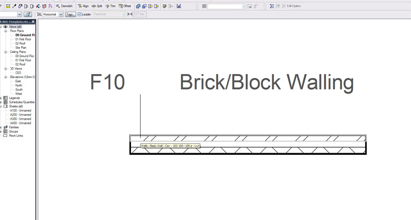

the first image shows the default keynote on a wall within Revit 2008 Architecture
as you will see you have the ref code and the description, this ref code is important to remember.

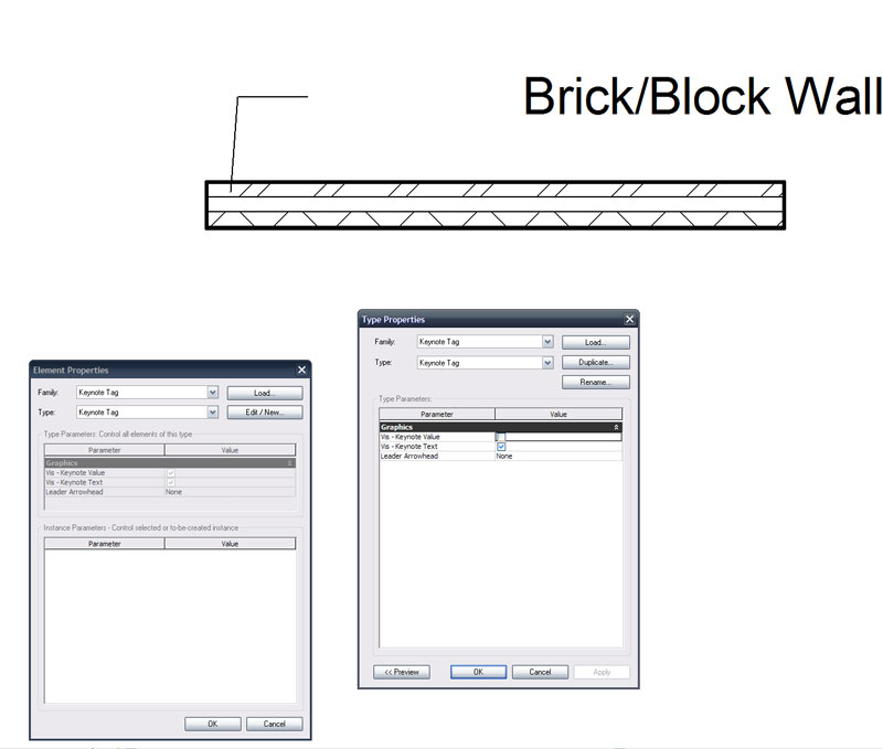

you can turn this ref code off by doing the following - see the 2nd imageclick edit properties button Cryingnext to where it has Keynote Tag) then edit/new and untick Vis - Keynote Value then click Ok

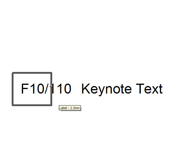

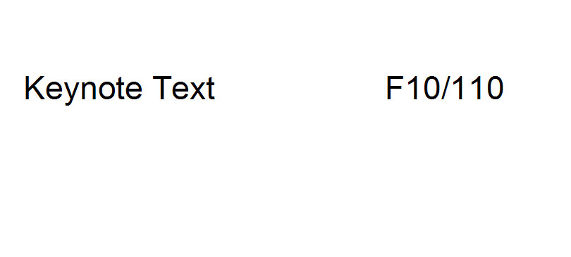

you will notice that the ref code has gone but left a big gap to the description text, to edit this you will need to do the following
click on a keynote within the drawing and then click the edit family button and click Yes to open now all you do is drag the description text to where the ref code text and vice versa
see pictures 3 and 4
click load into project and your keynote should now be like pic 5
hope this will be of some help
