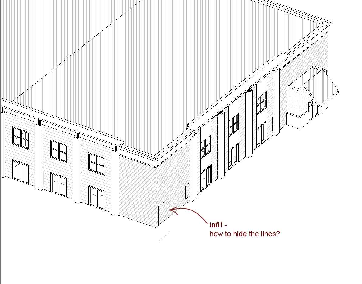

Hi all,  I'm using Revit Architecture 2008.  I created an existing building model and demolish some windows in the new construction phase.  The lines of the infilling are showing up on the model and elevations, is there a way to hide those lines?  Thanks!

I don't understand why but revit makes this infilling non-structural even if the original wall was structural. Select these infillings and set them to structural. The lines will disappear.
