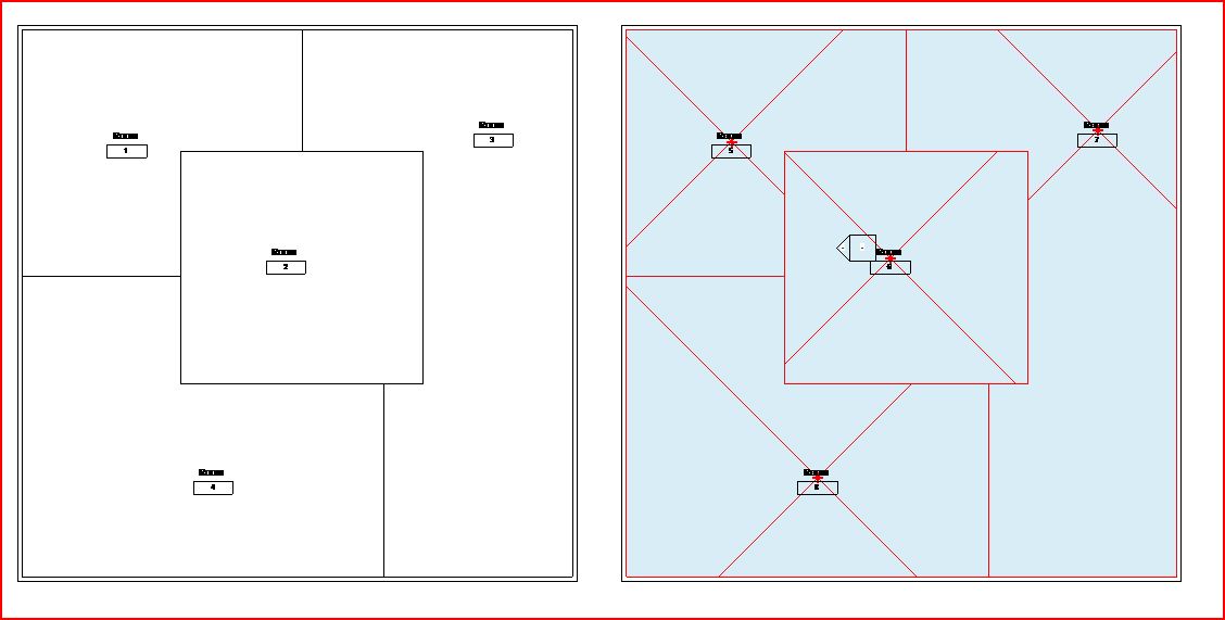

When it comes in really handy is if you have, say an open living area and you want a tag for Kitchen, Living, and Dining.  If you allow Revit to just place a tag into the space (using the walls you drew as the seperation) you would only get one room tag.  By adding a rectangle around the kitchen, one around the dining, and one around the living, they are now three different rooms.  (note you don;t have to make a rectangle, as Revit will automatically use walls as another boundary.  I attached a screenchot for you, maybe it will help.  The plan on the right shows the areas.  The lines that re drawn are the room seperation lines.Cheers.
