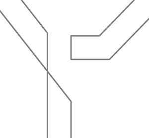

That must be the reason why. I guess I got all scared for no reason. Thanks. Have you ever experienced any problem with three walls joints working with worksets? I posted a thread about it yesterday. I am still experiencing problems with this issue and I can not figure what I am doing wrong... Thank you Hiroshi. Post edited on 2005-02-16 21:39:21

here is another example

drag the bottom wall so it unjoins from the two other walls. Trim them together so they join as expected. Use the wall join tool on the end of the lower/unjoined wall and select "disallow join", then drag the wall end right up to the face of the horizontal wall. This will fix the problem, however you will end up with a line between the walls. Bet than the alternative though.

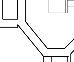

That worked for one particular case but what would you suggest in a case like the one attached?

Ensure you are using the latest build. Make sure all adjoining walls are part of the same workset, if not change them so they are. Then, I'm assuming you have got them to display properly and these are the ones that are losing the joins when you reload worksets of save to central?, anyway use the trim tool and the wall join tool to get them to join correctly. Hopefully it will retain this data when you save to central then... Disallowing joins obviously won't be much help here, either that or become friends with filled regions to cover over the joins themselves... HTH.
