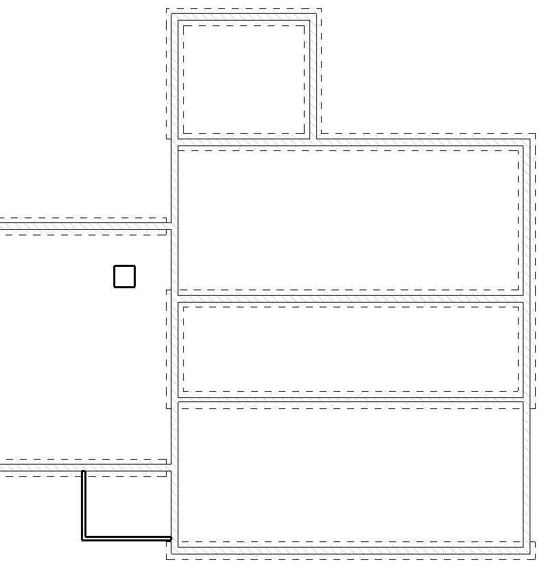

Does anybody have an idea what can be hapening with my foundation walls? They don't display the full length of the wall they belong to (see image). This is suppose to be a "staight forward" command, Under "Structure" you select "Foundation" then "Wall" and you pick your wall and the footing should show under your wall, but for some reason is being cut at the intersection with other walls. I have been playing with "Edit Wall Joins" but no results. Any ideas?

I tried to duplicate this but it is working fine for me. have you changed anything in the properties? what if you click on the missing wall section again? what if you do the perimeter and than the inside walls?

If I try to click in the missing section again there is nothing there (only can pick the wall). If I erase the inside walls the footing shows fine, but when I draw the inside walls again isome areas disappear. I haven't change any settings (that I know) I am using a standard cmu wall. My file is quite heavy now but maybe I can make a copy of these objects if you want to take a look at it (if you have the time, of course). Please let me know. Thanks

if you can make a copy and delete everything else. try and make it as small as possible and i'll have a look when i get a minute (or two)
