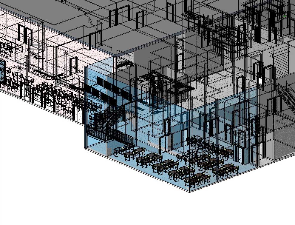

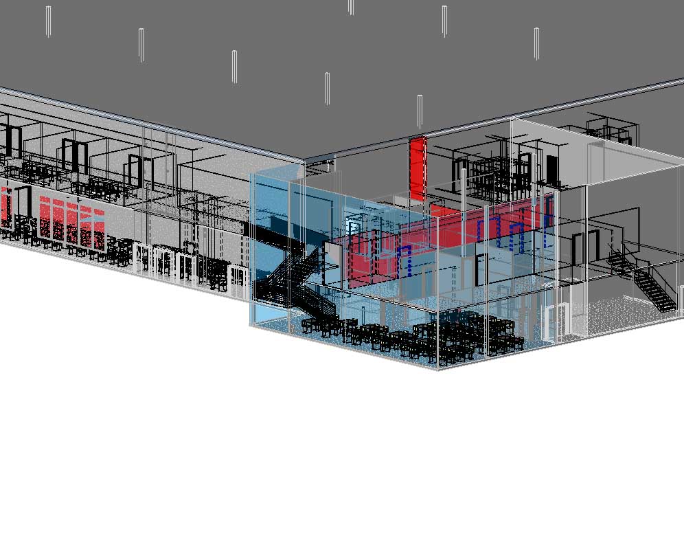

Nope.  I am the only one working in the file at this point and I have not set anything to transparent.  I am really lost as to why this is happening.  I am going to attach 2 images here.  1 is from the 3D view where everything is showing transparent.  The other is a camera that I placed where the image is coming in as shaded with edges.  So it must be a setting just within the 3D view.  Maybe I did not create a new 3D view the right way when you asked me to do that the first time.  What steps would you take to do that?  Thanks.

From your first image it looks like the view is set to wireframe and the phase is set to be Show All.  I agree check your overrides in your phase settings...
The second image looks fine.  The corner element appears to be a mass and by default the mass material is transparent cyan...  Change the material of you mass or apply walls to its faces.

OK.  I switched from show all to show complete in the phase.  and it is in shaded with edges.  i am attaching an updated image b/c now it shows the materials but it is still looking wireframe.  is there somewhere else i should change the shading - i am doing it in the bar at the bottom left of the screen.  i also checked VV and there isn't anything selected as transparent!

You other 3D view looked fine so I'd be inclined to say that this one is a corrupt view.
Delete it, then click the 3D button at the top of screen to have revit generate a new {3D} view.
