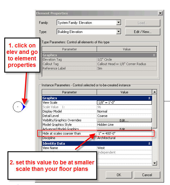

Another approach is to set a value in the 'hide at scales courser than' box in the properties of the elevation.  For instance your floor plans are at 1/8" scale and you want the elevation markers not to show on the site plan which is at 1:200.  Then set the properties of the elevation to not display at scales smaller than 1/8".  See the attached image for further explanation.
