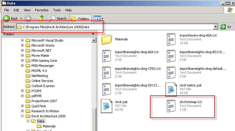

For fonts, be sure that you include in your Revit .shx font map the appropriate mapping you want to occur.  Locate the file as shown in the attached picture and follow the instruction in the font map file when you open it in a text editor.
As for existing details done in CAD, create drafting views for each of them and simply LINK them in (do not IMPORT).  Once they are linked in the details act like xrefs as changes to the CAD file will update the Revit drafting view.  When placing a callout for the detail or section be sure to check the 'reference other view' box on the options bar and choose your drafting view with the appropriate detail.
